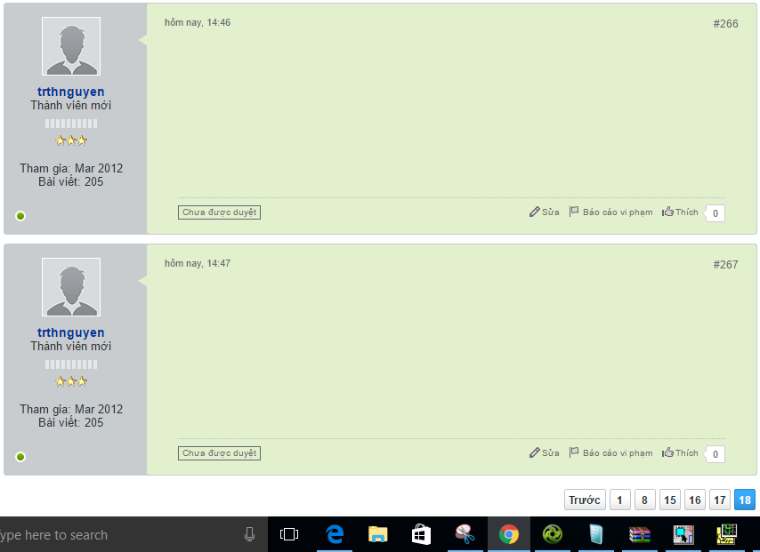

                              • ?????????????????????????????????????????????????? ?????????Click image for larger version
