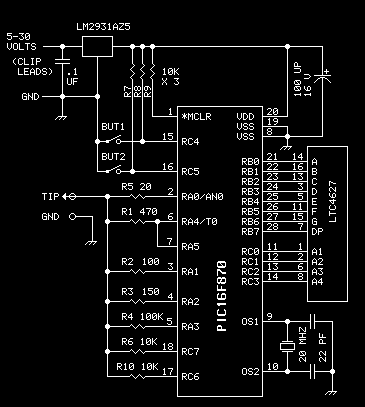

Tự chế siêu tester bỏ túi (super probe)
  • Tự chế siêu tester bỏ túi (super probe)
    So với cái probe của tui làm thì cái VOM chỉ là đồ chơi ,
    Không mất nhiều tiền mà còn ....gọn hơn cái VOM rất nhiều 17 chức năng đo
    Prob - Logic Probe
    The logic probe shows 'H' for high (over 3.7 volts), 'L' for low (below 0.8 volts) and '-' for floating in the first display location. If a pulse is detected (0.5 usec minimum), the second location flashes a 'P'.
    PULS - logic pulser
    The logic pulser shows the pulse rate (5, 50, 500, 5.0) in the last 3 locations. The first location shows the sensed logic level as a dash in the bottom or top of the digit. When button #1 is held down, a series of 0.5 microsecond pulses are generated in the opposite direction and the center segment is lit. Pushing button #2 cycles thru the 4 pulse rates. The selected pulse rate is saved on power down.
    FrEq - Frequency Counter
    In the frequency counter mode, hitting button #1 switches the display to the next 4 digits of the count. For instance, the display shows '12.57' for a frequency of 12,576 hz. Holding down button #1 shows '2576' - the lowest 4 digits. If a decimal point shows, the value is in Khz, if the decimal is flashing, the value is in Mhz. Hence, a frequency of 42,345,678 hz is displayed as 42.34 with a flashing decimal. Holding down button #1 in this case will display 5678.
    Cnt - Event Counter
    In the event count mode, the display shows the lowest 4 digits. Button #1 switches to the next higher 4 digits while held down. Button #2 resets the count.
    VoLt - Voltmeter
    The voltmeter uses the power going into the probe as a voltage reference. The current implementation shows only an approximate voltage - about 2% high. This can still be very usefull for most measurements. Do not connect the probe to voltages that exceed 5 volts under any conditions.
    diod - Diode Junction Voltage
    This is just the voltmeter function with 10k resitor feeding current to the probe tip. When a diode or transistor junction is connected from the tip to the ground lead, the drop voltage is displayed.
    Cap - Capacitance Measurement
    When a capacitor is connected from the tip to the ground lead, and button #1 is pushed, its value is displayed. Values from .001 uf to about 500 uf are displayed. The larger the capacitor, the longer it takes to measure. A value of 100uf takes a couple of seconds.
    Coil - Inductance Measurement
    When an inductorr is connected from the tip to the ground lead, and button #1 is pushed, its value is displayed. Values from 0.1 to 999.9 millihenries are displayed. Note: this function assumes that the DC resistance is not more than a few ohms. Also, if the unit gets 'stuck' in this mode, jumper the tip to ground to free it.
    SIG - Signal Generator
    This mode generates a 500hz squarewave at about 0.5 volts. The signal is only generated while button #1 is held down.
    ntSC - Video Patern
    Generates an NTSC video frame with a white dot pattern when button #1 is held down.
    9600 - Serial Ascii
    Each time button 1 is pushed, the letters A-Z followed by cr/lf is generated. Auto polarity sensing. If the signal injection point is orignally high, then normal (zero start bit) ascii is generated. Otherwise, the other polarity is done. New feature: Button #2 cycles thru 1200, 2400, 4800, 9600 baud.
    Midi - Midi Note
    Sends note number 60 (middle C) on any of the 16 midi channels. Holding button 1 sends 'note on'. Release of button 1 sends 'note off'. Buttton 2 cycles thru the 16 channels. The midi channel number is stored.
    R/C Servo
    Generates 1ms to 2ms pulse for r/c servos. Button 1 increases pulse, Button 2 decreases pulse. Defaults to 1.5 ms each time mode is entered.
    [ ] Sqaure Wave
    Generates 1 - 9999 hz squarewave. Button 1 decreases frequency, Button 2 increases frequency.
    Prn - Pseudo Random Number
    Generates 10khz digital PRN series.
    ir38
    Generates 1 millisecond on and 2.5 millisecond off of 38khz square wave. When connected to IR LED, used for testing IR reciever modules.
    PWM
    Generates variable pulse width 3-97 percent of a 6khz (approx) digital signal. Button 1 decreases pulse width, Button 2 increases pulse width.
    In any mode, holding down both buttons exits to the menu. Once there, releasing and pressing button #1 cycles thru its modes forward. New Feature: Button #2 cycles thru

        vấn đề là đo có chính xác không ?
        nhiều ứng dụng chỉ cần căn cứ vào cây kim có "động đậy" hay không,nếu dùng cái này thì hơi mệt
        dù sao cũng khá ấn tượng,bác cung cấp link đi

              ... sorry, bác post bài chỉ thấy toàn là COPY rùi PASTE mà không thấy trích dẫn nguồn này lấy ở đâu???... đưa schematic... source HEX... mà không đưa source CODE (em cần cái CODE hơn là cái HEX)... còn cái mà anh em rất cần là đường link thì bác lại "giấu kỹ quá như mèo giấu ...con vậy"...hihi...

                  it's unpractical anyway. Chỉ làm đồ chỏi mà thôi. Ai mà xài cái này trong thực tế được. Tầm hoạt động quá thấp.
