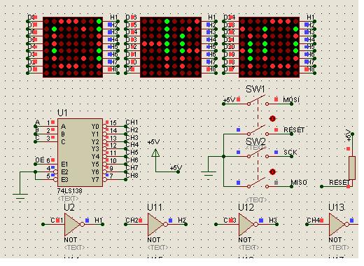

Code:6. Hien chu CHAO (giong chuong trinh XINCHAO) /***************************************************** This program was produced by the CodeWizardAVR V1.25.8 Standard Automatic Program Generator © Copyright 1998-2007 Pavel Haiduc, HP InfoTech s.r.l. http://www.hpinfotech.com Project : Version : Date : 7/27/2008 Author : Nguyen Hai Ha Company : www.softviet.net Comments: Chip type : ATmega8515L Program type : Application Clock frequency : 16,000000 MHz Memory model : Small External SRAM size : 0 Data Stack size : 128 *****************************************************/ #include <mega8515.h> #include <delay.h> // SPI functions #include <spi.h> #define SCK PORTB.7 #define DATA PORTB.5 #define SCL PORTB.3 #define B PORTC.1; #define C PORTC.2; #define OE PORTC.3; char lenX=9; char NoLed=3; unsigned char flash XINCHAO[]={156,136,112,162,72,137,130,40,138,130,47,138,130,232,139,162,40,138,156,40,114,0,0,0}; unsigned char DMem[24]; // Bo nho man hinh, 3 byte dau cho hang 1, 3 byte tiep theo cho hang 2 ... unsigned char r=0; unsigned char i; void LatchData(){ SCL=0; SCL=1; } // Timer 1 output compare A interrupt service routine interrupt [TIM1_COMPA] void timer1_compa_isr(void){ spi(DMem[r*3+2]); spi(DMem[r*3+1]); spi(DMem[r*3]); LatchData(); PORTC=r+8; r++; if (r==8) r=0; } void main(void){ // Timer/Counter 1 initialization // Clock source: System Clock // Clock value: 15.625 kHz // Mode: CTC top=OCR1A // OC1A output: Discon. // OC1B output: Discon. // Noise Canceler: Off // Input Capture on Falling Edge // Timer 1 Overflow Interrupt: Off // Input Capture Interrupt: Off // Compare A Match Interrupt: On // Compare B Match Interrupt: Off TCCR1A=0x00; TCCR1B=0x0D; TCNT1H=0x00; TCNT1L=0x00; ICR1H=0x00; ICR1L=0x00; OCR1AH=0x00; OCR1AL=0x25; // Quyet dinh toc do quet OCR1BH=0x00; OCR1BL=0x00; DDRB=0xFF; DDRC=0xFF; SCL=1; // Timer(s)/Counter(s) Interrupt(s) initialization TIMSK=0x40; // Global enable interrupts #asm("sei") // SPI initialization // SPI Type: Master // SPI Clock Rate: 4000,000 kHz // SPI Clock Phase: Cycle Half // SPI Clock Polarity: Low // SPI Data Order: MSB First SPCR=0x50; SPSR=0x00; for (i=0;i<=23;i++){ DMem[i]=~XINCHAO[i]; } while (1){ } }
Bác nghaiha cho e hỏi chút xíu.Hai dòng lệnh khai báo màu đỏ sao e không thấy sử dụng.E đã mô phỏng theo bài của bác nhưng chữ hiển thị không dc đầy đủ.
Những ô màu xanh không sáng.Bác xem và kiểm tra lại giúp e.E rất thích bài viết của bác về chủ đề này.E cám ơn!YM :
