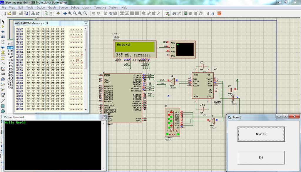

Đã lưu vào được trong eeprom và xuất ra được LCD nhưng gữi "HELLO" thì chỉ nhận được "HELO"
Không biết là do lập trình AVR hay VB đó mọi người
Help Help????
Code:
VB:
Private Sub Command1_Click()
Dim i
Dim s As String
s = "Hello"
For i = 1 To Len(s)
MSComm1.Output = (Mid(s, i, 1))
Next
End Sub
Private Sub Command2_Click()
Unload Me
End Sub
Private Sub MSComm1_OnComm()
If (MSComm1.CommEvent = comEvReceive) Then
bien = MSComm1.Input
End If
End Sub
Private Sub Form_Load()
MSComm1.CommPort = 2
MSComm1.Settings = "9600,N,8,1" 'tan so baub(bit rate),bit chan le,bit du lieu, bit stop
MSComm1.InputLen = 0 'Doc toan bo buffer
MSComm1.RThreshold = 1 'Khi nhan 1 ki tu se phat sinh su kien CommEvent=ComEvReceive(T)
MSComm1.PortOpen = True 'Mo cong
End Sub
AVR:
// Include library files
#include <stdio.h>
#include <stdlib.h>
#include <avr/io.h>
#include <avr/pgmspace.h>
#include <avr/eeprom.h>
#include <avr/interrupt.h>
#include <util/delay.h>
#include <inttypes.h>
#include <avr/wdt.h>
#include "lcd_lib.h"
//Definitions
#define CMD_PING 3
#define CMD_READ_EEPROM 4
#define CMD_WRITE_EEPROM 5
#define ACK_OK 100
#define ACK_ERROR 99
// Prototypes
void init_usart(unsigned int baud);
void init_io(void);
void txbyte(unsigned char data);
unsigned char rxbyte(void);
void startup_tasks(void);
void out_debug(unsigned char output);
void out(unsigned char output);
unsigned char out_state(void);
volatile unsigned char u_Data;
//------LCD------
//Ham xuat chuoi ky tu ra man hinh LCD
static int LCDsendstream(char c, FILE *stream);
//Dat chuoi ky tu xuat ra LCD: tao bien lcd_str co kieu la FILE(th.bi ao)
static FILE lcd_str = FDEV_SETUP_STREAM(LCDsendstream, NULL, _FDEV_SETUP_WRITE);
//Dieu chinh ham LCD stream de su dung duoc voi ham printf()
static int LCDsendstream(char c , FILE *stream)
LCDsendChar(c);
return 0;
// Let's go
int main(void)
//-----LCD------
stdout = &lcd_str;// khai bao LCD la thiet bi xuat nhap mac dinh
//--------Khoi dong LCD----------
LCDinit(); //Khoi tao LCD
LCDclr(); //Xoa trang LCD
LCDcursorOFF(); //Tat con tro nhap nhay tren LCD
startup_tasks(); //Boot procedure for microcontroller
while(1)
{ //Infinite loop, let ISRs do all the hard work from now on
unsigned char uart_lcd_test[]="UART & LCD Test";
init_usart(103); //Init the USART (Serial) for 3.68Mhz clock at 9600 Baud
sei(); //Enable interrupts
// Setup serial I/O for communication
UBRRH = (unsigned char)(baud>>8);
UBRRL = (unsigned char)baud;
UCSRB = (1 << RXEN) | (1 << TXEN) | (1 << RXCIE);
UCSRC = (1 << URSEL) | (1 << UCSZ1)|(1 << UCSZ0);
SIGNAL (SIG_UART_RECV)
u_Data =UDR;
printf("%c",u_Data);
eeprom_write_byte ((uint8_t*)u_Data, (uint8_t)u_Data);
txbyte(u_Data);
void txbyte(unsigned char chr)
while (bit_is_clear(UCSRA,UDRE)) {}; //cho den khi bit UDRE=1
UDR=chr;
unsigned char rxbyte (void)
while ( !(UCSRA & (1<<RXC)) ); //Wait until there is a byte to be read from RX buffer
return UDR; //Get it
}Last edited by vuong321; 13-05-2013, 17:19.
