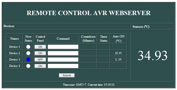

          Có nhiều bạn hỏi mình cái giao diện như attach file.
          Đây là mã của nó, nap code rồi lấy lại file html nhé. Mình đang test trên atmega128 nên lười chạy lại module atmega132.
          HTML Code:
          PROGMEM char Page1[] = {"<!DOCTYPE html PUBLIC \"-//W3C//DTD XHTML 1.0 Transitional//EN\" \"http://www.w3.org/TR/xhtml1/DTD/xhtml1-transitional.dtd\">"
          "<html xmlns=\"http://www.w3.org/1999/xhtml\" dir=\"ltr\" lang=\"en\"><head><meta http-equiv=\"Content-Type\" content=\"text/html; charset=UTF-8\"><title>AVR web server</title><style type=\"text/css\">"
          ".on { border:1; width: 20px; height: 20px; background: blue; text-align: center; padding: 0px; color: #fff; -moz-border-radius: 10px; -webkit-border-radius: 10px; border-radius: 10px;}.button{width: 100%;}"
          ".off { border:1; width: 20px; height: 20px; background: white; text-align: center; padding: 0px; color: #fff; -moz-border-radius: 10px; -webkit-border-radius: 10px; border-radius: 10px;} .button2{width: 80px;}"
          "</style></head><body bgcolor=\"#d0d0d0\" align=\"center\" style=\"padding: 75px 0px 0px 0px;\"><table bgcolor=\"#2F4F4F\" id=\"root\" border=\"1\" align=\"center\" width=\"868px\"><tbody>"
          "<tr><td colspan=\"4\" height=\"100\"><b><div align=\"center\" style=\"font-size:25pt; color:#FFFFFF\">REMOTE CONTROL AVR WEBSERVER</div></b></td></tr>"
          "<tr align=\"left\"><td height=\"25\" valign=\"top\" width=\"75%\"><b><div style=\"color:#FFFFFF\">&nbsp;Devices</div></b></td><td height=\"25\" valign=\"top\" width=\"auto\"><b><div style=\"color:#FFFFFF\">&nbsp;Sensors (<sup>o</sup>C)</div></b></td></tr>"
          "<tr><td height=\"auto\" valign=\"top\" width=\"200\"><p></p><div><form method=\"POST\" action=\"\"><font color=\"#FFFFFF\"><table width=\"95%\" border=\"1\" align=\"center\" id=\"table_device\">"
          "<tr align=\"center\"><td width=\"15%\">Names</td><td width=\"9%\">Now States</td><td width=\"11%\">Control Panel</td><td>Command</td><td width=\"15%\">Countdown (Minutes)</td><td width=\"11%\">Timer Status</td><td width=\"15%\">Auto ON (<sup>o</sup>C)</td></tr>"
          "<tr align=\"center\"><td>Device 1</td><td><div class=\"%CL1\"></div></td><td><input class=\"button\" type=\"submit\" value=\"%RS1\" name=\"RL1\"></td><td><input type=\"text\" name=\"Auto1\"/></td><td>%CD1</td><td>%TS1</td><td>%TA1</td></tr>"
          "<tr align=\"center\"><td>Device 2</td><td><div class=\"%CL2\"></div></td><td><input class=\"button\" type=\"submit\" value=\"%RS2\" name=\"RL2\"></td><td><input type=\"text\" name=\"Auto2\"/></td><td>%CD2</td><td>%TS2</td><td>%TA2</td></tr>"
          "<tr align=\"center\"><td>Device 3</td><td><div class=\"%CL3\"></div></td><td><input class=\"button\" type=\"submit\" value=\"%RS3\" name=\"RL3\"></td><td><input type=\"text\" name=\"Auto3\"/></td><td>%CD3</td><td>%TS3</td><td>%TA3</td></tr>"
          "<tr align=\"center\"><td>Device 4</td><td><div class=\"%CL4\"></div></td><td><input class=\"button\" type=\"submit\" value=\"%RS4\" name=\"RL4\"></td><td><input type=\"text\" name=\"Auto4\"/></td><td>%CD4</td><td>%TS4</td><td>%TA4</td></tr>"
          "</table></font><p align=\"center\"><input class=\"button2\" type=\"submit\" value=\"Submit\" name=\"SUB\"></p></form></div></td><td height=\"auto\" align=\"center\" width=\"auto\"><div style=\"font-size:50pt; color:#FFFFFF\">%AD</div>"
          "</td></tr><tr><td colspan=\"4\" height=\"25\" width=\"auto\"><div align=\"center\" style=\"color:#FFFFFF\">Timezone: GMT+7. Current time <span>%TI</span></div></td></tr></tbody></table></body></html>"};

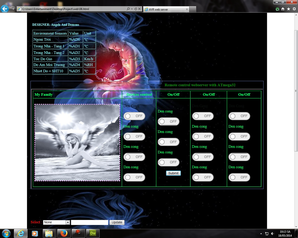

          • Share thêm 1 giao diện cho mọi người lựa chọn ^^!
            HTML Code:
            <!DOCTYPE html PUBLIC "-//W3C//DTD XHTML 1.0 Transitional//EN" "http://www.w3.org/TR/xhtml1/DTD/xhtml1-transitional.dtd">
            <html xmlns="http://www.w3.org/1999/xhtml" dir="ltr" lang="en">
            <head>
            <meta http-equiv="Content-Type" content="text/html; charset=UTF-8">
            </head>
            <link href="https://googledrive.com/host/0B72N5RrTAnASQVhUTWFXRzRGbGs" rel="stylesheet" type="text/css" />

            • Mình làm trên Atmega32 chạy bình thường nhưng chuyển lên Atmega128 , thay đổi một số config cho phù thì ko chạy được, có bạn nào làm được rồi chỉ giúp mình với
              • Nguyên văn bởi 123lazyboy Xem bài viết
                mình làm chạy bt mà? thay đổi phần uart0 thôi. chạy được luôn
                • Hix, mình tắt luôn cả uart, chỉ đổi phần vector ngắt với config lại chân thôi mà ko chạy được, bạn share code cho mình với được ko
