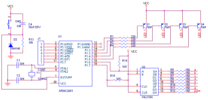

              Góp vui với mọi người , đây là đoạn chương trình đếm thời gian, dùng thanh ghi dịch 74LS164 để hiển thị LED :
              #include <AT892051.h>
              #include <intrins.h>
              #include <stdio.h>
              #define BYTE unsigned char
              #define WORD unsigned int
              #define LED1 P1_2
              #define LED2 P1_3
              #define LED3 P1_4
              #define LED4 P1_5
              #define Data_164 P1_6
              #define Clock_164 P1_7
              char code Led[]={0xC0,0xF9,0xA4,0xB0,0x99,0x92,0x82,0xF8,0x80,0x9 0,0xF9,0xFF};
              struct time { /* structure of the time record */
              BYTE hour; /* hour */
              BYTE min; /* minute */
              BYTE sec; /* second */
              BYTE dem,LedCount=0;
              struct time ctime = { 0, 0, 0 }; /* storage for clock time values */
              void Display(BYTE );
              void Tmr1Int() interrupt 3 using 2
              if(++dem==200)
              dem=0;
              if (++ctime.sec == 60)
              { /* calculate the second */
              ctime.sec = 0;
              if (++ctime.min == 60) /* calculate the minute */
              ctime.min = 0;
              if (++ctime.hour == 24) { /* calculate the hour */
              ctime.hour = 0;
              //scan four LED 7 segs
              if (LedCount++ >=4 )
              LedCount=1;
              switch(LedCount)
              case 1:
              Display(Led[ctime.sec%10]);
              LED1=0;
              LED2=1;
              LED3=1;
              LED4=1;
              break;
              case 2:
              Display(Led[ctime.sec/10]);
              LED1=1;
              LED2=0;
              LED3=1;
              LED4=1;
              break;
              case 3:
              Display(Led[ctime.min%10]);
              LED1=1;
              LED2=1;
              LED3=0;
              LED4=1;
              break;
              case 4:
              Display(Led[ctime.min/10]);
              LED1=1;
              LED2=1;
              LED3=1;
              LED4=0;
              break;
              default:
              break;
              TH1=0xEC; // Interrupt 5ms
              TL1=0x78;
              // TH1=0xF4; // Interrupt 3ms
              // TL1=0x48;
              TR1=1;
              main code here
              void main()
              TMOD=0x10; // timer1,mode1 (16 bit)
              TL1=0x78;
              ET1=1; // Enable timer1 interrupt
              TR1=1;
              EA=1; //Enable global interrupt
              dem=0;
              LedCount=0;
              while(1) {};
              void Display(BYTE Dulieu)
              BYTE i;
              for(i=0;i<8;i++)
              Data_164=Dulieu & 0x80;
              Dulieu<<=1;
              Clock_164=0; // Clock for '164
              _nop_();
              _nop_();
              Clock_164=1;
